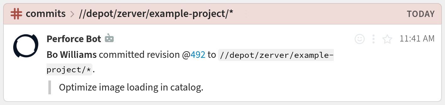

You're done! Your Perforce notifications may look like this:
