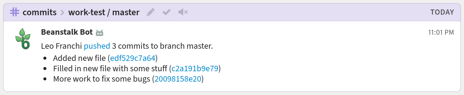

You're done! Your Beanstalk notifications may look like this:
